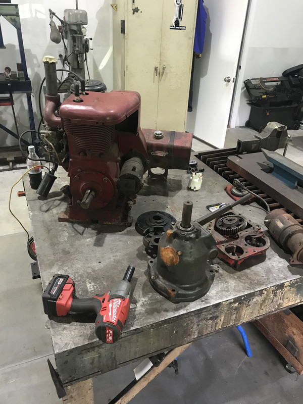

If anyone is in the ri area, I just pulled a thd out of storage. I thought of getting it running but may just sell for parts. Not stuck, was running but governor/throttle linkage needs a spring or 2. Has some extra parts, gears/starter and a pto. The pto would not fit without shortening the shaft. Motor ran with a belt/pulley setup not pto. Maybe someone could use pto on another or use this crank as donor to cut down.
I guess I could sell parts but would prefer it to go as a package. Open to trades for rusty gold.

Made up some linkages and hit up the scrapyard for some parts to make a runner.
Got it spinning, a lot of afterfire and some backfire. Found the exhaust valves stuck open (common in this motor)
So now it seems the timing is 180 off or maybe 360 as the intake sounds like the exhaust. Switching the plug wires gets the puff out the exhaust. More to do

Ok running like a top, I have to time it, cut shaft for pto and add a generator circuit

I would NOT cut the crankshaft to accommodate the clutch unit. Typically there are more differences between clutch engines and regular engines than just the crankshaft. If memory serves the rear bearing plate is different and maybe the crankcase.
There's not too many applications around that use those engines and most of them are plain output, making the engine easier to sell as is.

Pulling the flywheel, looks like a different case around the oil seal on this engine vs the one the stator came off of. I will make a hub and adapter, pics to follow once i go though my scrap pile

Just a note, if you're going to load the engine be sure to put the screen back on the shroud as this is needed to get air flow past the vanes. Free running it is no problem without it.
