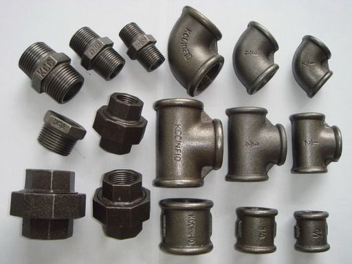

This is what we buy here in the Netherlands.
I guess this is what you call the beaded style?
Unfortunately they are galvanized.
I can easely get 500 however 500.000 will be more difficult

Here is one place that has them. Shipping won't be cheap, but at least they speak English. If you order some, I would like to get in on the order.
